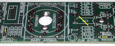

My kits arrived yesterday, so I figured I'd start a thread. A little backround: I'm kind of a newbie, though I've done a few small mods and simple builds, I'm still kinda "flying" blind. I've been lurking here since the board was in "the old country" before it moved here, but never got around to doing anything. Now I've got the time and the need, so here I am.
One thing not included in this kit is any kind of step by step How-to. This is fine with me as it requires me to think, be inquisitive, and learn a bit in the process. Perhaps we can build that "how to" here and save Joe the trouble of 1) writing one, and 2) having to field tons of emails from newb's like me asking mundane questions, like the ones I'm about to ask!
I ordered a pair of Baby Animal kits with the JLM99v opamp, the JLM 1:4 xfmr, and two DI kits. They arrived nicely packed in a little box and got here pretty fast:
Sorry, honey, you're going to have to eat your dinner on the couch the next few days ("You mean for a change?!")... Anyways, everything seems to be of very good quality.
Here is the bare PCB and should give you an idea of how small they really are:

Note that there aren't any specific schematics for the configuration I have, but both have plenty of info to draw from and should be sufficient. Or they would be if I didn't have my head up inside myself. So here are a couple questions:
Should I be installing the zeners, resistors, and regulators in notes 2 and 3 of the first ("full") scematic? I'm using the 48v supply here. I am of course trying to find this info myself but perhaps having it here will help others...
Here is a small capacitor and my dirty fingernails :oops: :
There are two of these. Are these the 0.1uf's that mount near the opamp? I've been trying to look it up but there are no other markings, and I cannot even tell what color that is.

Hi J
The cap you are holding is a 47pF k series ceramic. This has text on one side in yellow but they are hard to read at the best of times but great caps otherwise.
The 0.1uF mono chip cap is a yellow or blue bead type in the baby animal kit.
When running 48v power supply no reg parts are needed for the 48v phantom power rail (* parts) and if the opamp can run on 48v it also doesn't need a regulator (# parts). Just 2 wire links (BD681 C-E) need to be fitted to link out the regulators as shown in the photo above.
The link across the DIP IC between pin 4 and 7 is to pull the inverting output to ground so the output balancing will still work without a output transformer when using a JLM99v or Hybrid.

Thanks Greg and Joe for the help! I get it now. Well, sorta :razz:
Joe, I hope you do not mind me working through this here. My hope was to actually spare you the trouble of having to deal with questions like mine over and over.
You can actually see remnants of text on that cap in the picture better than you can see them with the naked eye. Does the color on top denote anything? I tried looking it up but found nothing relevant (just some stuff about old paper and mica caps).
I also see the 0.1uf cap (mine is yellow). That one actually has text on it that I should have looked up :oops: . I actually had some of that stuff printed out before but lost it.

Okay. Couple curiosities...
1) in the schematic,  there is a 470R resistor on the phantom switch, as well as two 470R's on the Pad. Now, I've only got two 470R resistors per pre. I did notice in this pic the 470R is omitted from the phantom switch (the pre in the forefront):
Did I accidentally eat my resistor? :oops: It looked delicious. Or are these only necessary for a >48v PSU?
2) For jumpering between pins 7&4: Can I do this by putting a jumper in the DIP socket? Having the socket installed seems useful to me, and i COULD solder the jumper on the back, but this seems easier. When I tried it out, the jumper (a clipped lead) fit nice and snug.

Quote
No sounds good to me as there are so many possible combinations on the Baby Animal PCB it should help heaps to have this thread. If everyone building Baby Animal just posts on this thread with questions it will save me many emails which is a good thing and I will be notified as soon as they post and I will try to respond ASAP.
Quote
I was about to blame Matt for packing the kits wrong :wink:. But I just checked and I stuffed up the part list. So you are right you are 1 x 470R short.  :oops:
All baby Animal kits posted before today's date will be one 470R short. Parts list now updated. Thanks J. Let me know if you need me to post you the resistor or if you find any other bits that don't add up.
Quote
When using the pushbutton Switches the 470R for the phantom power and RP have to be mounted on the opposite side of the PCB to the switches.
Quote
Either way sounds like good idea to me.

« Reply #13 on: April 25, 2006, 01:45:53 am »
Quote from: "JLM Audio"
Heh. I'll see if I can find a couple tomorrow. No worries! Everything else is good.
Quote
I thought about that and then forgot :oops:
Other than that everything is great I think!
